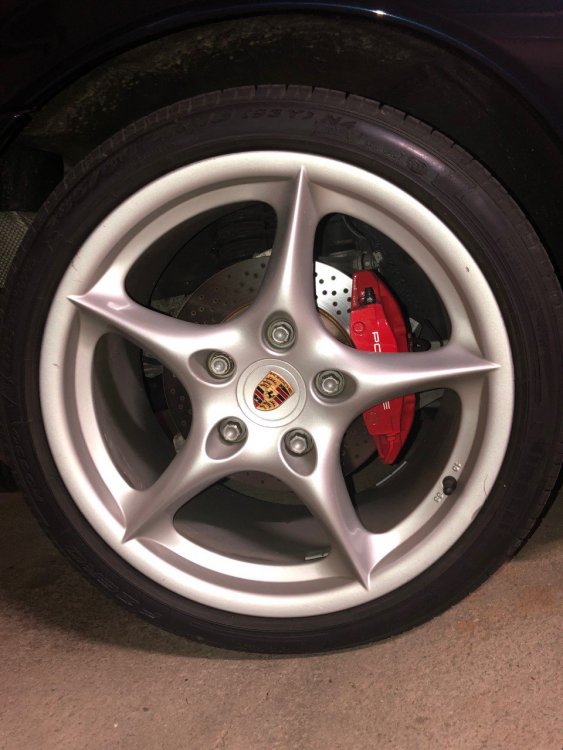

I'm going to be fixing some minor scratches on my wheels that were there when I bought my car a couple of months ago.
Will WURTH SILVER METALLIC paint be an exact match for my wheels?
Please see attached pic.
Thanks.
Thanks again.
Unfortunately Wurth's doesn't make that exact can anymore. I'm sure it's been superceded over the years.
Both of the links I provided say they match all German cars.
I might have to take a leap of faith.
