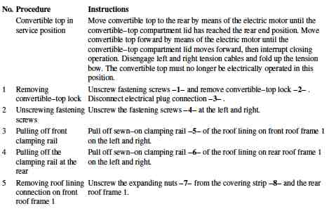

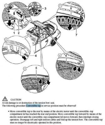

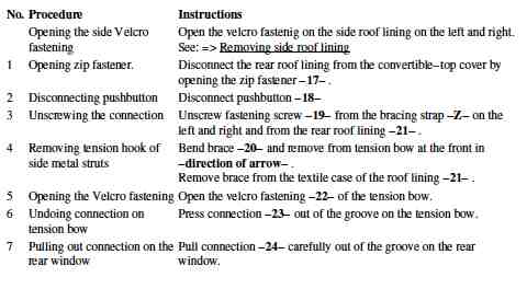

Like most 996 owners I have issues with rattles in my 2002 cabriolet. There are excellent instructions for removal of the door panel, which I will use to attempt to locate a rattle in the passenger side door, but another rattle (more like constant tapping) is right above my head in the roof.
If I reach up and press on the panel right above the driver seat the tapping stops. When I let go it is right back again. This developed last fall and is back this spring (car is not driven in winter).
I have searched here and at Rennlist and cannot find anything on this. Can anyone tell me where I could find instructions to pull back the cabriolet headliner to inspect the roof to try to isolate and stop the tapping. Any advice appreciated.
