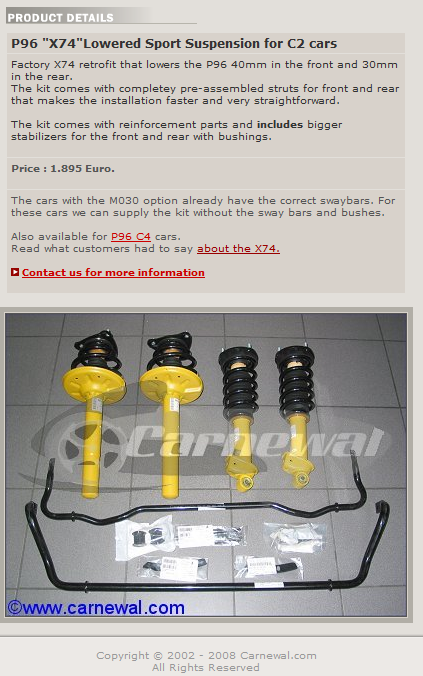

Here I stand with a Row M030 kit sitting in my garage when I thought I ordered a X74 kit. After Three days of back and forth with the dealer. They are telling me that the X74 is not availible as a "KIT"
I have a 99 996 C2, 6 speed.
The kit that arrived is the 00004450027.
Will the 00004450035 kit really be the X74 and fit. Or can I make it fit. Also, what are the spring color markings for the front and rear.
Any help would be greatly appreciated
Thanks
Chris

X74 is not recommended for MY99 cars as the chassis was made stiffer in MY2002.
Both of the kits above are for MY02-04.
While it may not be recommended it will fit. It would seem that if people are installing the PSS9's or 10's on the car it can handle the X74.
Thoughts. This car is a street/DE car with about 10 events a year.
I did not say it will not fit - it will.
I caution you because it has been known to cause stress cracks in the early cars.
But it is your car do what you want.
