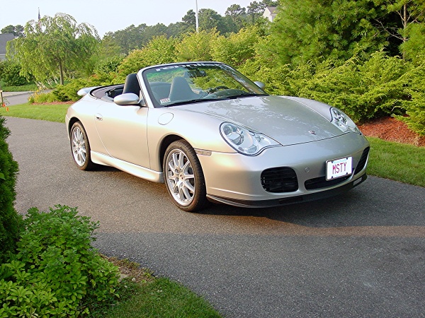

I talked with Don, but doesn't he have an older style front end than I do?
Hey Jenner, I think Don has the same front you are putting on. I would agree with Loren, Don is your guy. As for the 3rd radiator, do you see your temp in above average levels when you are driving around town or more importantly when you are tracking the car? That will help answer your question. Out here in Vegas I would definately install the 3rd RAD if I was going to live here longer than 1 more year. But since I am moving back to NoVa next summer I am going to pass on the 3rd RAD kit. Hope this helps a bit.
Dell
Based on pics of Dons car he has '99 style headlights. I have a 2003, so I am guessing the two are quite different.
Can anyone tell me anything about the eyebrows or other necessary parts? I'd like to have all of the parts ahead of time for the body shop.
I could have sworn he had an MY02. Here is a pic of his car with the new front (courtesy of Don's website). THose look like 02+ lights to me.
