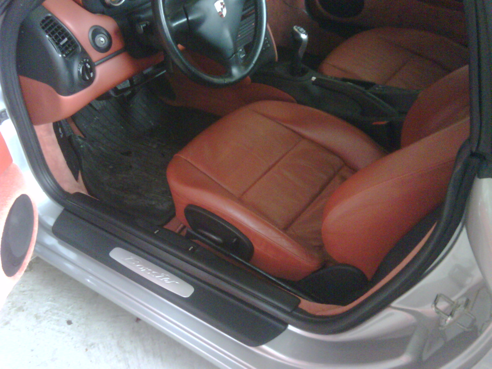

Just installed gauge rings and door sills into my 02 Boxster. Loving it and can't wait winter is done to drive her again. Spring, please come !

Did you have to cut the 987 sill's down or did you just leave the gap? Where did you get the Gauge Rings from, Suncoast is out of stock till March....
They look great by the way!

I left the gap, indeed i didn't know the gap will exist. I bought both items from Suncoast if they don't have them in stock, i could be the one who bought the last set. You may check out the following link and they are going for the same price.

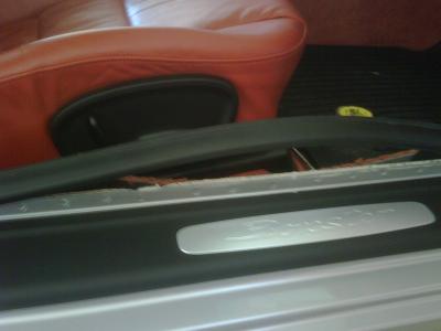

I was going to wait till the weather warms up a bit but couldn't resist the temptation, so, I used a hair dryer to warm up the panel before putting it on, this way, I can at least enjoy by watching it once in a while :P The arrow is pointing at the gap and if I weren't the one who put it on, I will never notice the gap exist and I will assume thats the way it is.

By the way, for the infamous GAP, would be an easy fill with black gasket sealant which is a silicone product.
Those are factory sheepskins off a 911, no bathmat here. ;) That black gets mighty hot in the summer. What is this gap everybodt talks about? There is no gap on our sills. I did remove/ pull up the door seals and plastic housings for the installation though.

How do you remove / pull up the door seals and plastic housings ? will it create damages and/or unable to put them back ?
The door seals just pull up. There is a bit of adhesive , but the seal can be pushed back down when finished. That plastic housing on the sill(holds switches/pulls) to the driver's side is held in by some allen screws. Remove the plugs to access them. For the passenger side, remove umbrella/rubber liner and torx screws are revealed. You'll notice when all of this is removed there is a "V" etched on the metal sill to center the door sills.
You should be able to readily pull all of this off without any damages and have a perfect installation
Regards

I guess this is kinda late now since the sills are pretty "glued". I did pushed all the way in and i think the gap is approximately 1-2 mm and is not very noticeable and like I said, if i wasn't the one who installed them, i will never notice it.

Fixed and no more GAP... I took out both of the inner sills, remove the door sills by fishing line, reapplied adhesive. Now is a perfect job. :clapping:
