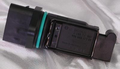

This is where the part number is located. I sell/sold MAFS on eBay for a long time, so we are not ALL bad :)
B
