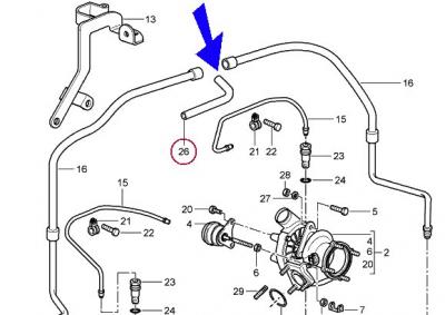

hi i installed a idp plenum in my 01 turbo and i cut the line that is suppose to be connected to the yelow check valve in this picture below
i am looking for the part# to the hose that is connects to the one by itself on the top right side.
i have a old hose that is connected right now and the hose collapse when i just start the engine because of the vacuum and its throwing the psm abs code and when i connect a pocket scanner to the car it show no codes

it doesn't show. on the 3rd picture can you tell me what hose is connected to the top right side of the 3 on the stock plenum?

Please specify the item number in the diagram - so I get the right one.
Thanks.
I *thought* it would show it in the tank diagram but it does not. That particular hose helps pull a vacuum on the oil tank and heads. The check valve is to keep boost from pressurizing the tank and heads.
B
thanks a lot Brad that is the hose i am looking for. how sure are you that the hose in your diagram is the one that is connected the plenum?
