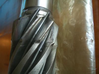

I have a 97 Boxster 986, 2.5, 5sp manual (New Zealand)

I had noticed (but not thought too much about it) 1st gear was getting noiser, other gears were fine, gear change was fine too
Took it in for a regular service and the Porsche service guys commented on it and suggested a bearing and I should schedule a time to strip the gearbox to see what was going on
Also told me to nurse it until then
So I started saving for a big bill haha
some time later I had it booked in and had the gearbox stripped
Bearings were fine,
Syncros fine
Layshaft 1st gear teeth had big pitting in several teeth
All other gear clusters where fine
Have attached the photos of the teeth

What does the mating gear look like? It looks like a manufacturing defect seeing how the porous area appears to be below the profile of the gear tooth. How much was the new shaft?

That'll do it in spades. I think greer put his finger on it, some kind of metallurgical flaw.

The mated gear was fine, only this layshaft and the end bearings needed to be replaced
All other parts went back into the box
Price for the shaft was about $1700 NZD from memory+ labour
I wonder if Porsche will come to the party and helpout out on this?

Andy, this doesn't look like wear to me...more like a defect inherent to the machining/mfg process. Just curious...how many miles on your gear box?

I had is fixed at about 100,000km
Not sure exactly when the problem staed as it sneaked up on me
But from 90,000km onwards for sure
Everybody who as seen it thinks it a defect in the steel and not normal
Its not like Porsche is going to come back to me as say sorry about that, here's a new gearbox for your trouble
But is nicer to know what actually went wrong
