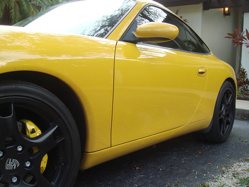

I have lobster claws from a 997 S and they fit fine. No spacers needed. Even that I'm running 235's in the front and 305's in the back. No rubbing.
These are the lightest wheels Porsche is making at this moment.
See pics.
I hope this helps!
