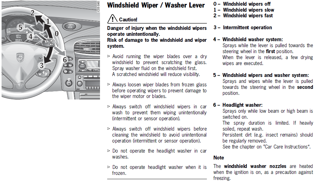

Does your car have Bi-Xenon headlights?
If you do then these are headlight washers.
If you have the stock Halogen headlights - then these are just covers.
Check for option code M288 - Headlamp Washer
If you do have them it is covered in the Owner's Manual.
