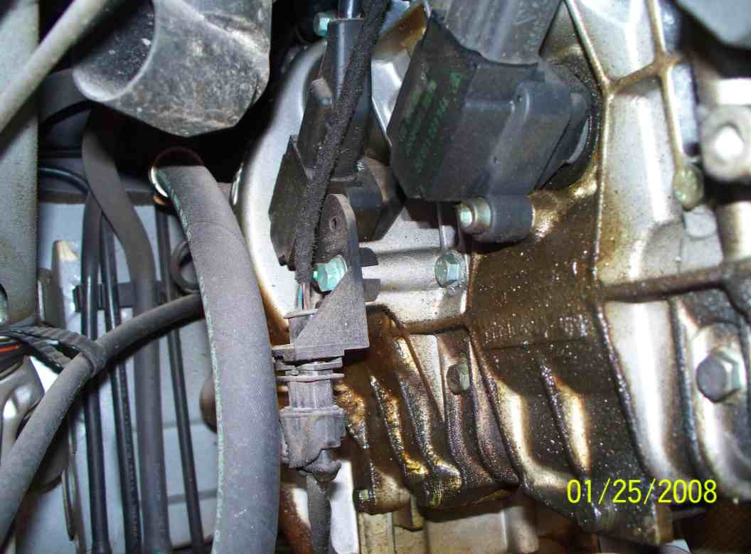

Are these leaks spark plug tube seals or cam cover? I think tube seals however wanted the board's opinion before ordering the parts.
If it's the tube seals, should both tubes and seals be replaced? '00 S, and they have not been replaced before. Thanx !

It appears as though it is the tubes. Order 6 tubes and there are 12 seals. Also get the proper tool for removal. I hear you can use a screwdrive end but it didn't work for me.

Chas:
There is a clear photo of a cam cover and all the related parts and possible sources of leaks at this link: http://mike.focke.googlepages.com/camcoverleaks
It might give you a better idea of where everything is situated and where your leak is originating, although from your photo, it does look like it's coming from the spark plug tubes.
