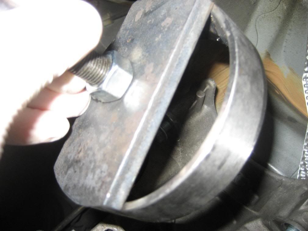

Or make your own :-)
Note the PVC "tool" in the background. (this was for a 986 3.2L - but similar concept should work for any M96 engine)
<img src="http://lh3.ggpht.com/_vWWL8dQ1nk4/SYUobi3HD0I/AAAAAAAAAhc/Nuc8s9RMzTU/s800/DSC03524.JPG" />
I unfortunately did not see this one in action.. but supposedly worked just fine!
M
Edited by txhokie4life
txhokie4life,
Unless you know, or can replicate the exact specs of the factory tool, you might just consider renting one. The inner lip on those PTFE seals(ptfe audi rms in pic) is fairly delicate. That inner lip can tear tear quite easily if the installation surface is not prepped propperly or the seal cants on installation.The seals are sensitive enough that Audi sells them installed to the back plate which just needs a gasket change. Not to be an alarmist, but those jobs are no fun to do twice.
