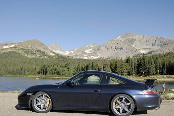

I used to live in CO, now in PA. I still get out there once in a while. It was quite a drive to/from PA. In any case, she (the gt3) was very happy in the mountains otherwise. photo from Brainard lake below (love the hiking).
