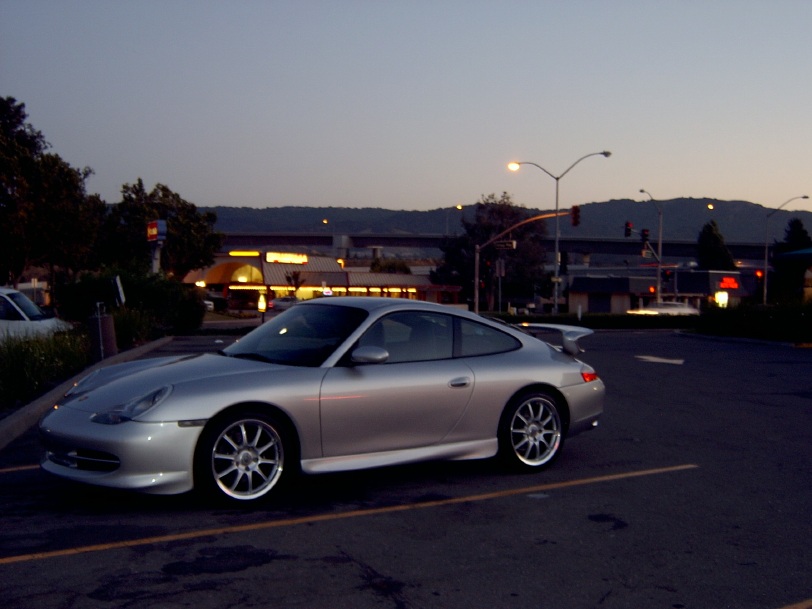

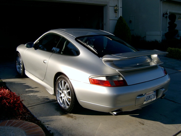

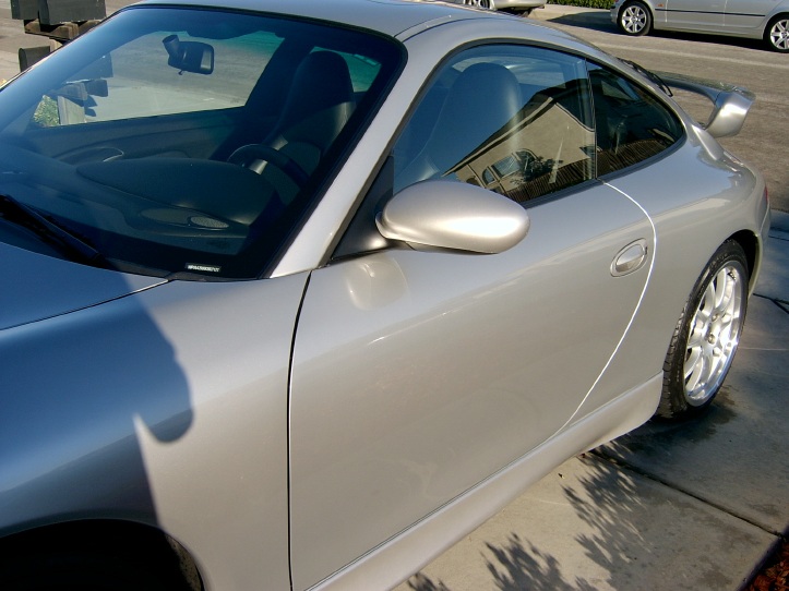

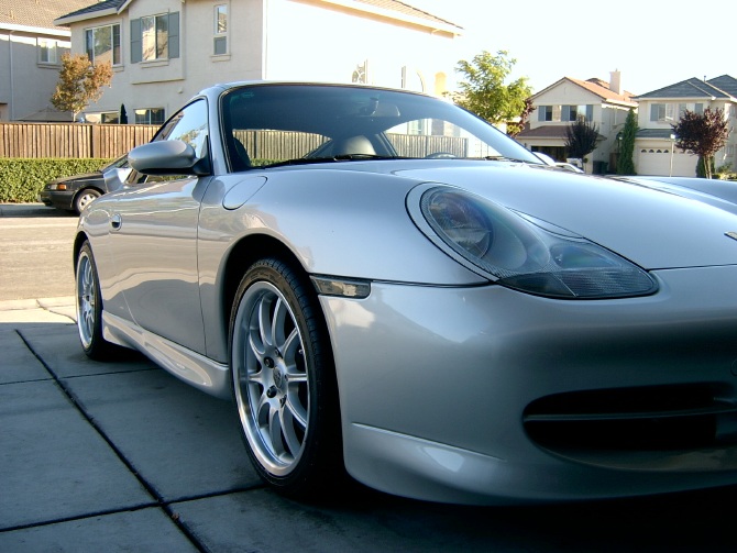

Aerokit and PSE installed! PSE surprised me, thought it was going to be kinda quiet since its a factory part, but really made me smile when i first started it up.

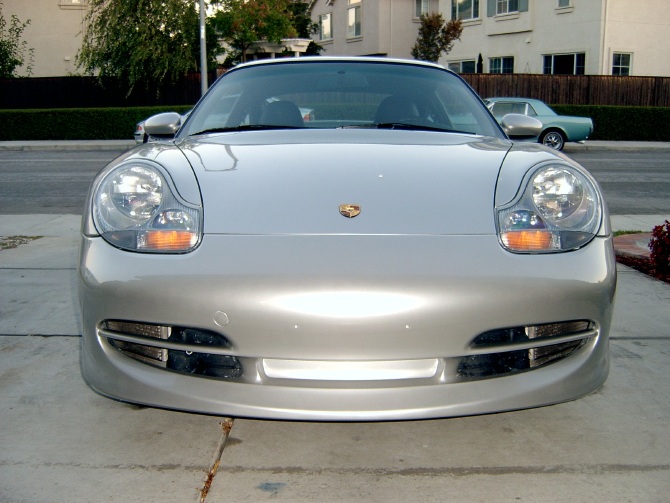

only thing left to install are the front spoiler and the rear gurney... Front spoiler was painted and installed, but then i scraped it and the paint like tore off.. so i took a it off and used adhesion promoter, so the paint will stick to the plastic.

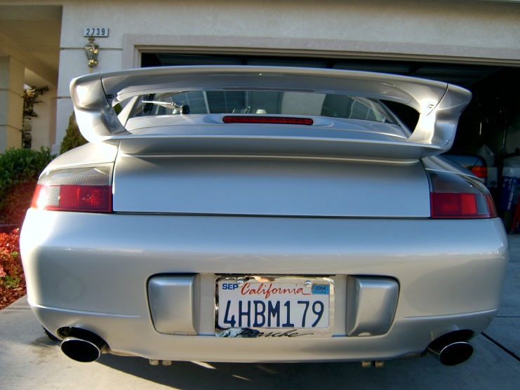

Your car looks great. I also do not have the carrera script on the back. I mostly like not having to clean around all the edges of the script when waxing. Your painted bumperettes change the color ratios. I am undecided if the black-colored script would be an improvement or detraction.
Your car would look great with the silver 911 logo. Considered it?
As for your spoiler (I assume you are referring to the lip spoiler)...the reason paint scratched off is becasue it is supposed to. That is why it is plastic and that is why it attached to the bottom of the GT3 spoiler (to protect the paint on the GT3 not the lip with is not supposed to be painted). Loren has the same color scheme as you so if you want to see what it looks like with the black lip spoiler on the AS car, check it out.
By the way, the kit looks great on the car and PSE you will love more and more everyday. Music to your ears!

My bad, you are correct......I remember talking to him about it and he said he has an unpainted one that is going on to replace the painted one in due time. Sorry about the misinformation.
:oops:
IMHO I think b/c it looks better. I don't think Porsche's intent was for it to be painted anyway. But some get it painted after the fact anyway. Basically it comes down to personal preference though.
My lip spoiler gets scratched all the time and it is undetectable to the casual observer. Guess its time to get a black car? Just playing. The AS looks great.

Its rather simple to prevent scrapes on most of Porsche's chin spoilers. Simply put a row of wide flange pop rivets along the bottom edge. I space mine 2" apart. You can't see them unless you stoop down and the 1/8" of extension lifts the spoiler enough to prevent virtually all scrapes from reaching it.
If you don't have a lift, a hole punch will easily go through the plastic.

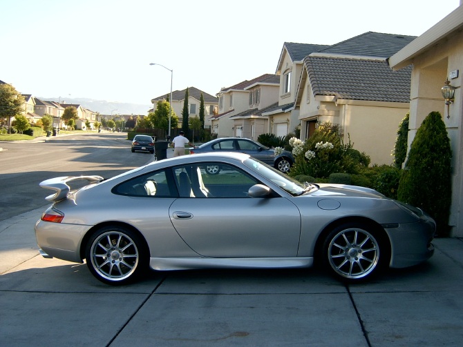

heres a shot
