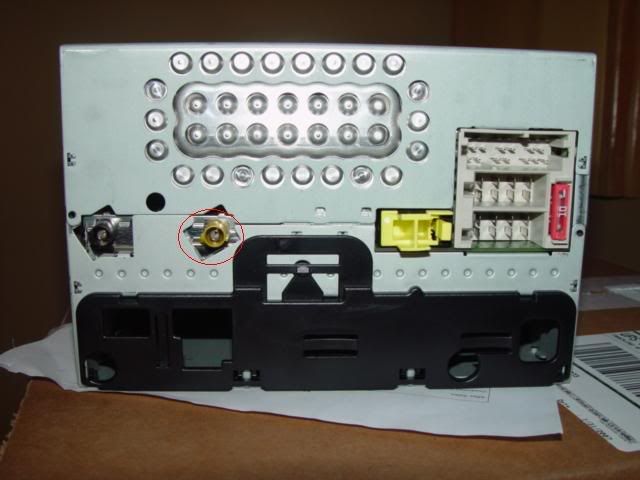

I was wondering though, is there an additional wire that runs from the sports chrono to the PCM? My PCM has 3 plugs (1 for power, one for MOST cable, and not sure what the 3 is for but it is plugged in) and 2 antennas (one for GPS and second one is unused). Is the unused antenna for the phone antenna? or is this for the sports chrono?
Is the radio (part of the PCM) antenna cable disappeared? Take a good look behind the PCM.
this is what the back of my PCM looks like... the plug circled in red is not used. everything is working (radio/GPS)
