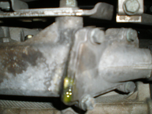

Where is it leaking from? The thermostat housing gasket?
Let me try and upload a pic (sorry about the marginal quality)...
Lennie:
That is your thermostat housing gasket leaking.
To avoid or minimize draining the entire cooling system, use a pair of hose pinch pliers to clamp the coolant hoses going to and from the thermostat housing before you remove the housing to replace the gasket.
The part number (for just the gasket) is 996-106-326-50 (about $4.00).
Edited by 1schoir
That is not the theromostat housing. Thermostat is on the other sdie of the engine at the water pump. However, you will need to collect the coolant when you remove the 4 -10 mm bolts to replace the gasket.

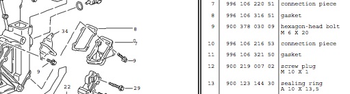

Finally got around to ordering the part number referenced above. It is an odd shaped gasket, not the rectangular one that I need. Can you double check the part number?
-Lennie
The gasket number specified earlier in this thread is the incorrect part. You need part number 996 106 316 51, as shown in the attached pic captured from the 996 PET:
Thank you very much THAT is the part i need!
