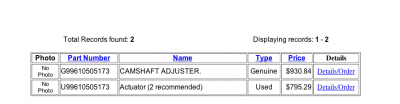

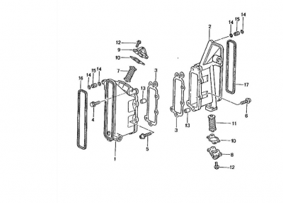

I am looking into the system and if the oil pressure conduit is not blocked the only other possibilities is the actuator itself directly onto the cam. The item 4 on the first picture. It is an expensive component as you can see....

As you presented, I should expect to pay like $750 to $850 for a new vario cam unit. But for example, what tools I would need for the disassembly/assembly procedure in order to be sure not to screw up the engine timing? In terms of engine removal, the manual is not that detailed in the steps they suggest for removal. Any good site with pictures that could enlighten my path?

They also got a dial indicator to found the top dead center but this is not a specific tool... Amazing what we can see when we look at the build up several times....Look at the oil conduits that feed the cam actuator...There will be some parts to purchase like the cam housing cover gasket, o-ring for the cam cover, gasket for the tension adjuster etc.
The repair manual also recommend to replace the bolt (M12) that hold the actuator to the cam. Item#5
