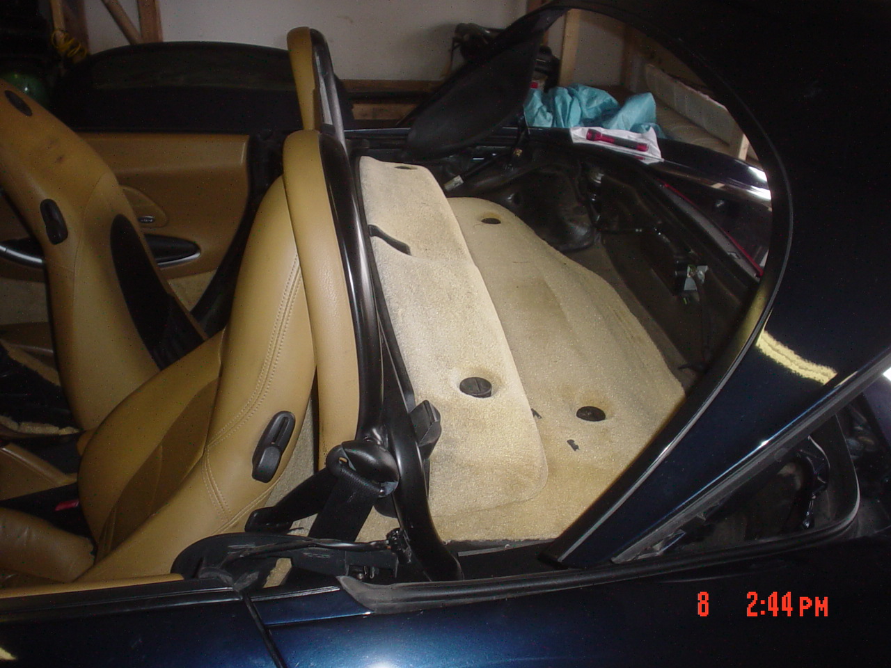

Also one of the rear compartments (the one behind the driver's seat) is jammed, does anyone have any removal instructions for it?
Thanks everyone!
The rear compartment on mine just slides open, to get a better look you could take out the complete unit, two large black turn screws. I think there is no base to it, it rests on the carpet so you might be able to see what is preventing it from opening, dried coca cola and old boiled sweets glued parts of my BM together....kids eh.
timbo, thanks a lot... I really appreciate your help. I will check it out in the morning.
