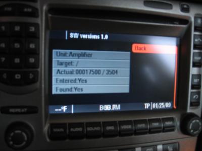

Before I had ever heard of this forum I bought the Nav upgrade, B, and tried to install it.
My amp bricked!
Searching around the net I found this and wished I found it earlier.
With the help of this forum and specially AP997S I got the CD upgrade to A and a used amp with the right hardware nr from eBay.
I got the amp (997.645.334.22) and installed it and now the
sound was back. The amps SW was 17500.
I then proceeded with the upgrade and it all worked fine.

Need some help: I have an early build 2005 997s
Here are pictures of my NAV Unit version screen:
Dealer wants to charge me $345.00 parts/tax and labor to update software with new maps.

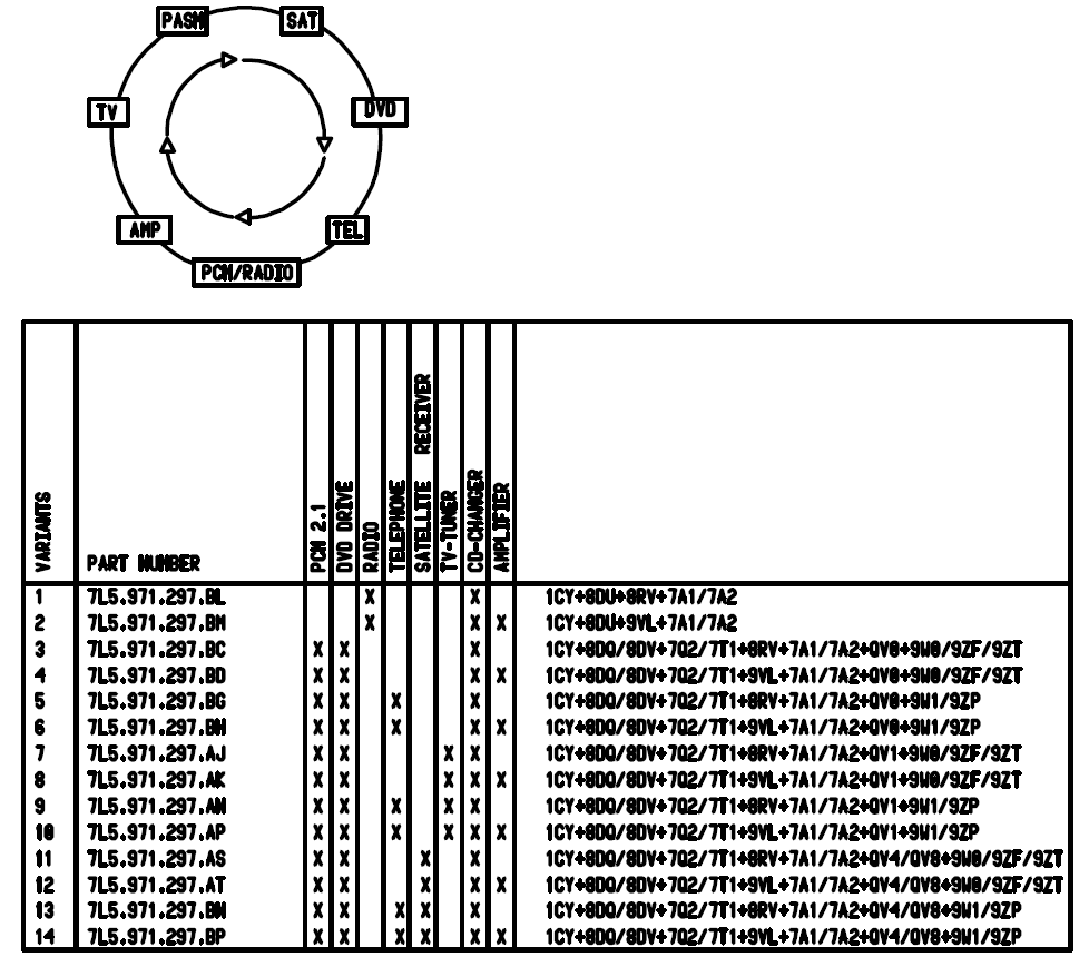

I am in the process of also updating my 2004 Cayenne which has CD based Navigation with a 2006 PCM and DVD Drive unit. I'm having a heck of a time determining which cables I need between the PCM and DVD Drive. I believe they are: 955-622-313-00 Optical Cable, 955-647-207-00 Coax Conn, 955-647-208-00 Connecting Cable. If the GPS antenna connects to the DVD Drive, if I disconnect it from my old PCM is there enough cable to re-route it to the DVD Drive below the seat. Sure hope someone can help with these questions. THanks in advance.

MY2006 Fiber Optic Cables - use the chart to find your options and the correct cables.
