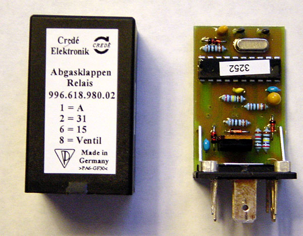

The relay should be in position 23 (lower left most relay position) and it should be labeled "Abgasklappen Relais". The part number may be different. Just pull it out to unlpug it.
Thanks. I take it I simply unplug it and leave it hanging there? Is PSE auto mute between 30-45MPH the only thing this relay effect? Will my PSE on-off switch still work?
As always, thanks so much Loren.
Just figured it out. My relay number was 996.618.980.03. I took it out and the exhaust didn't silence however my PSE switch no longer worked. Based on what I read, I would need to open the relay, remove the four prong jumper and insert the relay back into the panel. The PSE switch should now work without the auto mute between 3-5000 RPMs. Is this the correct procedure?
Thanks.
Thanks.
You do not open the relay the jumper is on the back of the relay panel.
If you want the switch to work then you need to do as original instructions said. Then find and disconnect the Speedometer A grey/pink wire for the PSE so that your PCM will not be affected.
