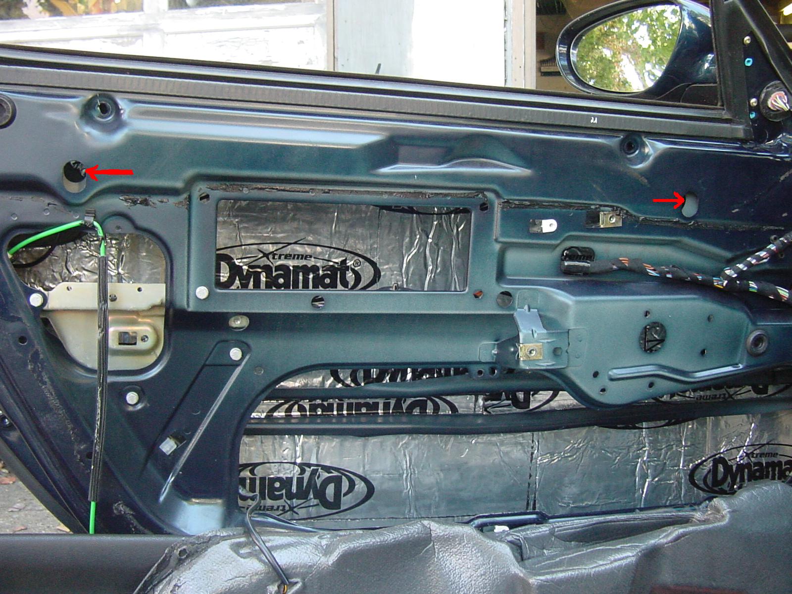

Here are a couple of photos that show the possibilities, with the first one being the most likely suspect:
The red arrows are pointing to where the window regulator legs are fastened to the inner metal door skin. Tighten the bolt that is in each of those spots. (Note that the window regulator and the bolts have been removed in this photo).
