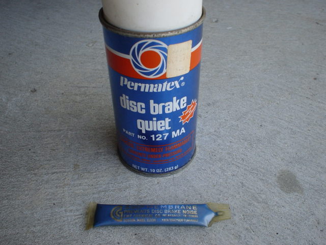

I have used this stuff on other cars. It glues the pads to the pistons. Not sure if it will help given the nature of the pad material, as stated above. In fact, I don't think this product did anything on any car I used it on. They add a material to friction material to reduce noise. Graphite or something like that.
The shop manual says not to put stuff on the back of the pads. But I think it is grease.
