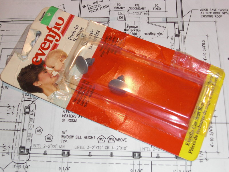

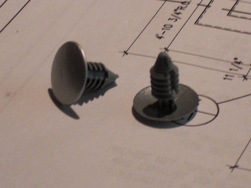

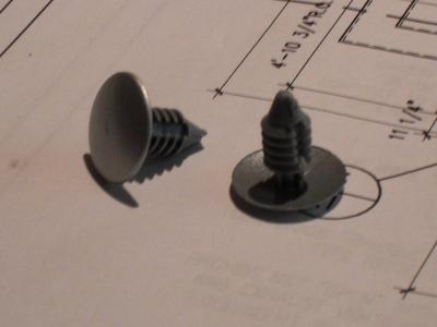

Sounds like you found a solution, but I thought I'd share something I picked up at the auto parts store near me.
These were miss-shelved, but appear to be child seat replacement parts. I couldn't find any more packages in the store but this is/was a box of 12 plugs for about $6.
They fit perfectly to cover the holes in my bumper and I sprayed them with silver Krylon paint for plastic that I already had to match my Arctic Silver.
I'm sure the Krylon isn't a perfect match for A S but on such a small item with a convex shape it’s not noticeable. I wouldn't recommend this for larger items like the bumperettes, as the color mismatch will be noticeable, not to mention the lack of a flex additive.
Larger auto parts stores may also carry misc. plastic plugs for significantly less $$ than the dealer.

Why didn't I think of that..........? Auto parts stores do have a veriety of plastic plugs for various OEM interior and exterior repairs. That would be a good place to look. By the way, I have that identical silver Krylon paint used to do some trim work on an Infiniti plastic engine cover that was modified to accomodate a plenum mod. It works great. Sticks like crazy and had no problem with the engine heat.
