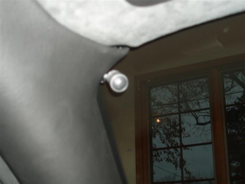

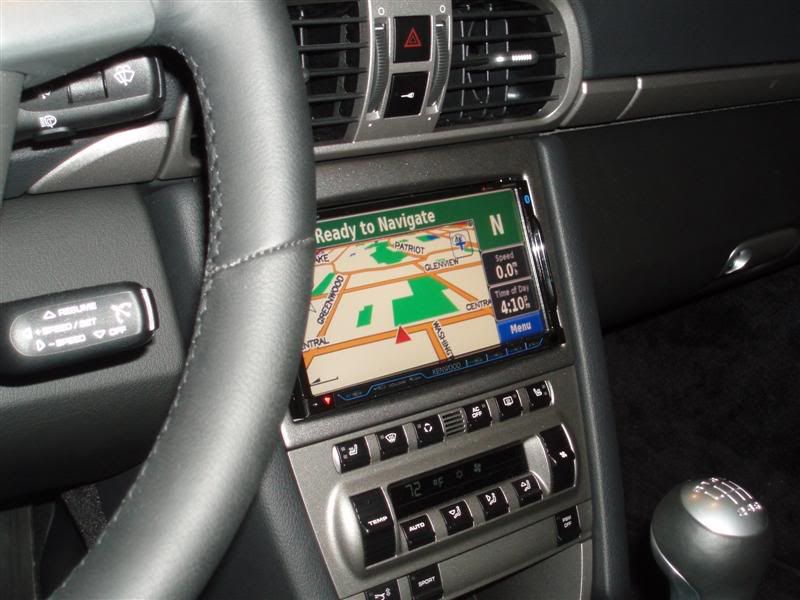

The unit all installed and setup. Navi antenna is up by mirror looks stock
bluetooth mic

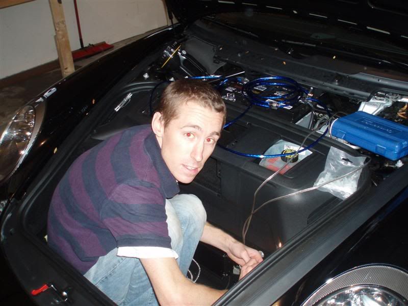

nice bein small gives me room to work and wire

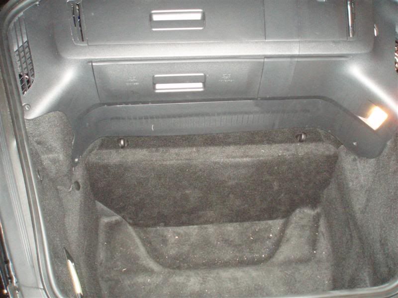

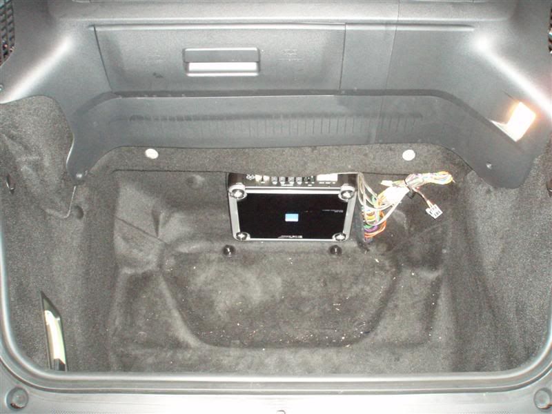

Now ya see it, now ya dont. Amp is basically 100% hidden, mounted where OEM amp is and only pushed panel out slightly

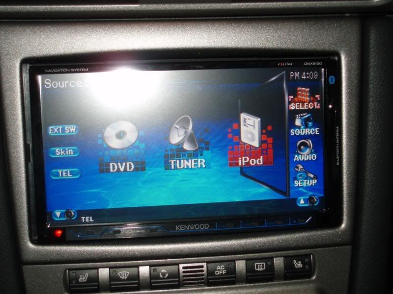

As for a review the DNX8120 is basically a killer unit. Having the multiband EQ was nice was able to make the OEM speakers actually sound really good. Having USB, ipod, and bluetooth all in one piece is nice. Ipod was routed into glovebox, oem ipod was in center counsle but without extensive modding it just wasnt going to happen. USB is hidden next to the counsle on the side.
The PDX made for a great install in the OEM amp location, ran some rcas out front, and literally picked up all the speaker wires right at OEM amp.
