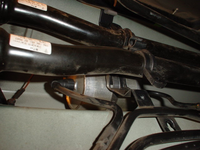

It it under the middle of the car behind the middle plastic cover. The round silver thing in the pic. I have changed filters on fuel injected cars and the Boxster is huge in comparison. Porsche says it is good for 60k miles. My friend owns a gas station. The fuel out of a nozzle goes through 2 filters before it goes in your tank. I doubt it is your filter - but replacing it the way to rule it out as the cause of the problem.

TP what tools do I need to replace the gas filter? Thanks!
