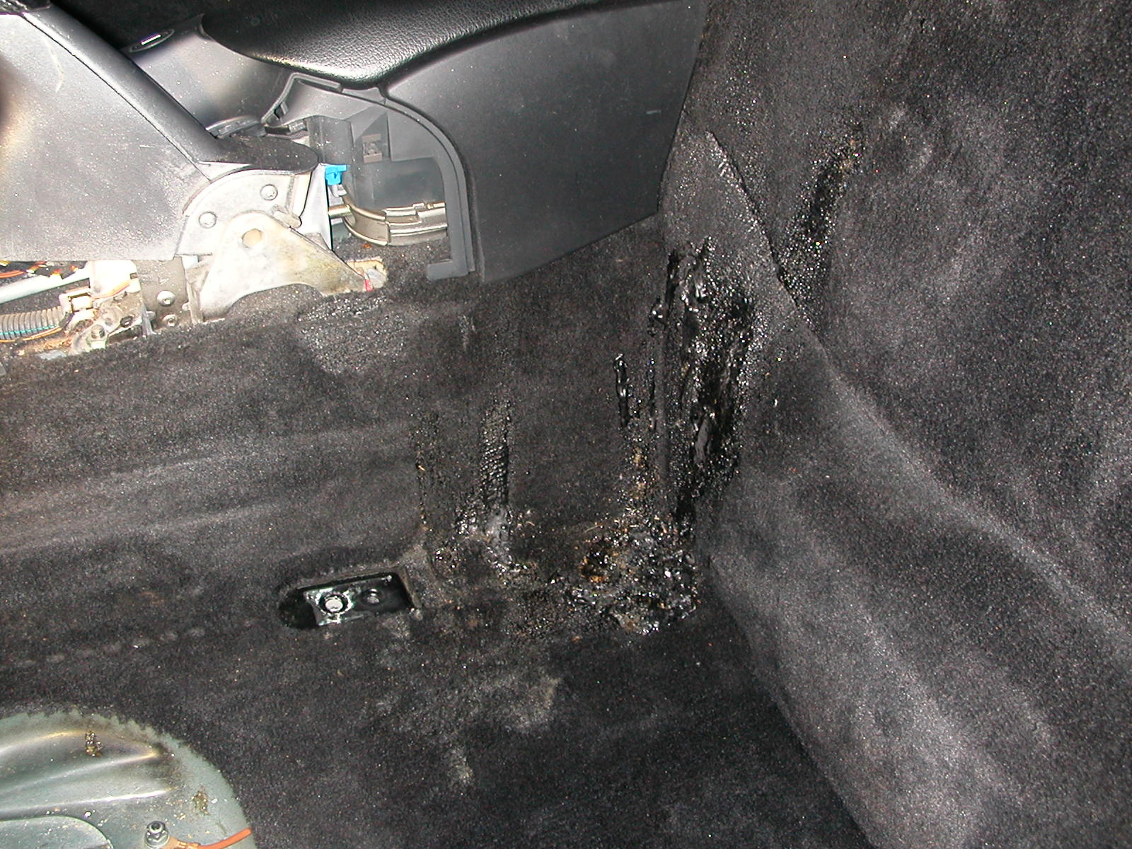

Take a look at these photos. Anybody got a clue what the heck the hard, rubber/plastic like residue is? I'm guessing maybe something melted caused by extreme heat from the engine. I'm not the original owner, obviously. The seat isn't damaged, but it appears as if the heat pad under the carpet is a little burned looking. I have no maintenance history on the vehicle and no carfax history of damage/repairs. Something happened, and I thought I'd throw this out there to see if the mystery can be solved.
The black stuff is really hard, like plastic. And the area around it on the carpet feels greasy.
In any case, there's always been a faint unusual smell in the car I couldn't pin down. Wonder if it's from a fire extinguisher? The carpet is a little greasy so I'm cleaning this week. I guess I'll just buy some similar looking carpet, cut out the damaged section, and replace. Anybody have any idea how much a whole new carpet for that area of the car would run me?

Nothing terribly flammable on the engine back there, that’s right about at the crank pully. If I remember correctly the fuel lines are to the rt. of the passenger side. It would take an accelerant to make a missed rim shot off the ashtray to burst into flames and do that sort of damage (maybe a spilled methanol martini)
Plastics like Nylon melt and have a slippery feel. Nothing weird there.

Hmm... it almost looks like melted tarring found on the back of dynomat which is used as the adhesive. When in doubt... rip it out lol. No to be honest, my guess is you'd have to purchase new carpeting for that area. Have you tried pulling back the carpet to inspect underneath?
I'm removing the sections today. I'll post back with pictures of what it looks like under the carpet. The upper half of the mystery gunked carpet does have burn marks which is why I thought the heat source came from the engine.

Well, I said I'd post back when I got the pictures of the carpet turned over. Not worth taking. More bad news.
The cushion material under the carpet was SATURATED with green liquid. There was a puddle in the seat/frame well as well. This may be why the heated seats aren't working. (something I was attempting to look into when all this came about)
The saturation in the cushion material went all the way to the front near the brake and accelarator area. Wet on the passenger side too. I hate to admit it, but I'm not sure what the liquid is. This must be the strange smell I've been getting.
I did find that the power steering fluid was empty. That's the dipstick near the air filter, right? Anyway...completely empty. Could that mean a leak somewhere that's filtered down under the carpet?
I ripped out the saturated cushion glued to the carpet, but assume it's going to require rooting around to find the leak and then hunting down a new carpet system altogether.

Green fluid does sound like good old Pentosin Hydraulic fluid used in the power steering system. The reservoir sits atop the engine pretty much in the area where the carpet has been damaged behind the seat.
If I were you, I'd do a very close inspection of your power steering lines. It is possible a plastic or rubber line has gotten damaged (melted?) and is letting fuid escape. There are several lines at the very front of the engine directly behind the driver seat running down to the floor pan area. It would be a shame for all your hard work and expense to be only temporary if you don't find the original source of the problem.
Justto close this discussion...I could not verify a leak from the coolant tank or the hydrolic fluid. (Another check of the hydrolic fluid showed it was full, just didn't realize the "full" level was so close the bottom of the dipstick). I did find the rainwater drain behind the driver's seat covered by a small piece of plastic. My final conclusion is that the previous owner must've had some kind of leak, fixed the leak but not the carpet. Since then, rainwater has been accumulating under the seats due to the rainwater drain not working.
