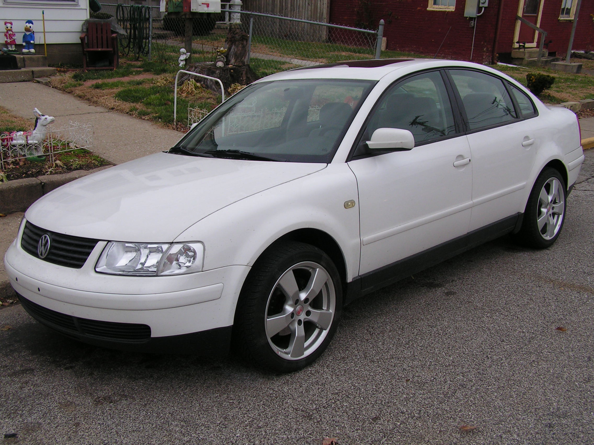

Well I learned to use it back in the 80's. and I have used it eversince and not had one issue using it to clean out the brass powder and lube grease that will build up over time and allow free movement again. You simply spray it in break down the greasy build up and let the excess drip away, and then use graphite powder to lube the cylinder. Oddly enough my 76 X1/9 had it done to it somewhere in the early 90's and they do not have a problem. Are they/you using graphite powder to lube the lock afterwards? Oddly enough I used the same method on my 01 Passat and it has not failed me yet. . . here's hoping.
P.S. don't look at the pic too close it needed a bath :rolleyes:
