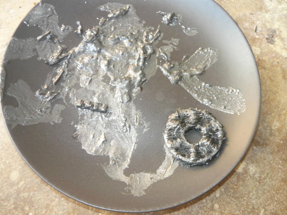

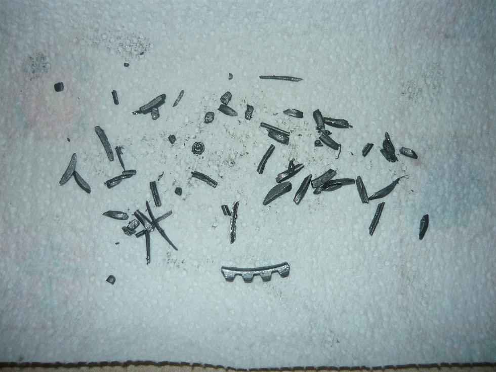

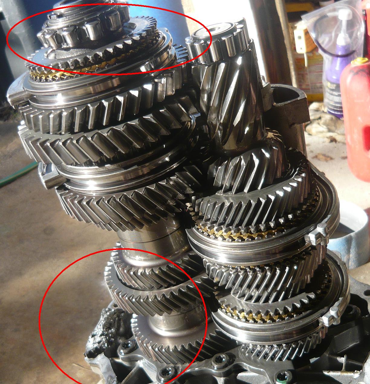

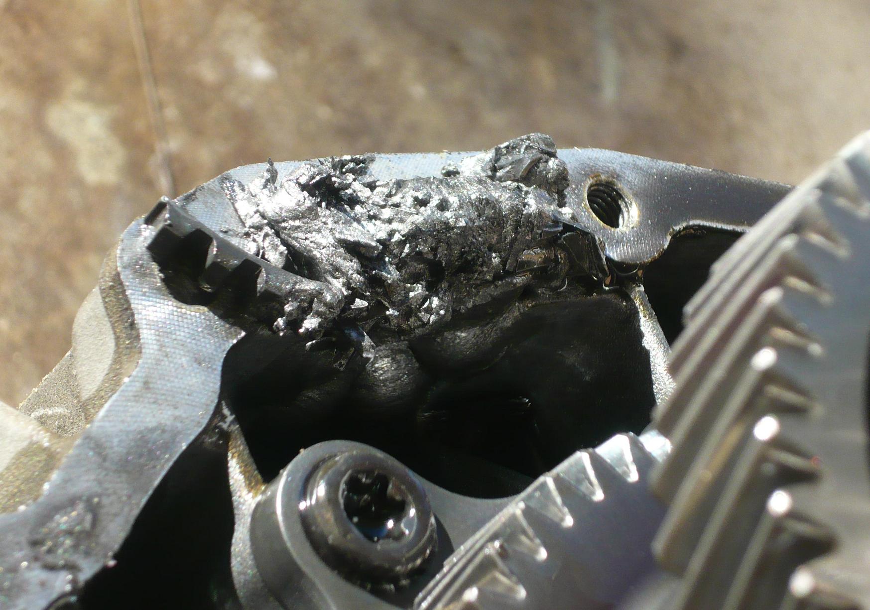

just so everyone knows yes i am being sarcastic, the new one is already in. I didn't know the transmission was in this bad of shape, finding chunks of metal and pieces inside. If everyone wants i have more pictures of the transmission guts. Symptoms were 1st gear popping out, 2nd gear grinding, and the transmission made a noise like a chattering clutch when decelerating, i would imagine from the worn main bearing
Edited by iornman86
Nice pics I am not sure but I think mine would look like yours. It is being replaced now too.
I did not have any issues with 1st, but 2nd kept wanting to pop out and it felt like it was not fully engaging.
From time to time if not thinking about it would grind a little. Like it was only partially engaged and then when you release the clutch there was not enough gear to gear and it would torque grind. Here's to new trannies!
