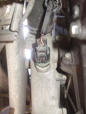

So, when are you going to try seeing if the coolant temperature sensor is causing the problem?
I already pulled that connection and cleaned it as you suggested. I haven't replaced the actual sensor, but I'm assuming it's ok since the temp gauge on my dash is working correctly.
I am not saying the sensor is deifinately the cause, although it is a common one, but a bad sensor will still povide accurate readings to the dampened down display.
