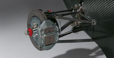

How about the Porsche RS Spyder?
No slots or cross-drilling.
