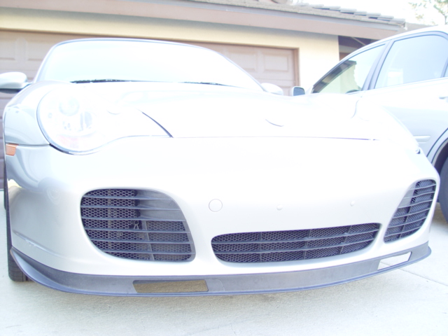

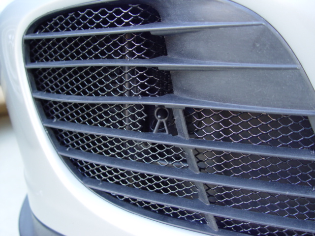

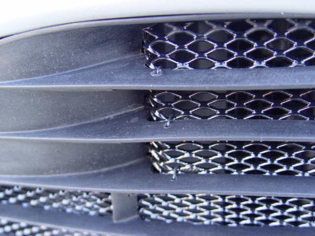

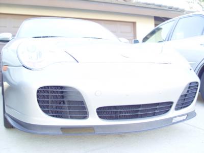

The best thing I ever did for the car is to install custom front grills. Keeps 95% of the road junk out! No effect on temp. Bad exposure on picture 1 so you can see the grills. You can see the simple attachment method in picture 3.
