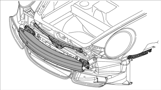

Here are the instructions from POSES. I have attached the 2 photos that go with these instructions. If anyone needs more instuctions on the 997 or any other model let me know via PM or email.

Removing front bumper
Removing the front bumper
Installation Location:
Overview, front bumper
Removing the front bumper 1. Unscrew fastening screws -1- and remove bumper -2- .

Installing front bumper
Installing the front bumper
Installing the front bumper 1. Position bumper -2- .
2. Insert fastening screws M12 x 100 -1- and tighten to the specified tightening torque. Tightening torque → : 63 ftlb.

Thank you for htose detailed pictures. I actually misworded the topic since scope of my work was to remove the front bumper cover/spoiler, not the actual bumper itself. Nonetheless, good reference. I appreciate it.
