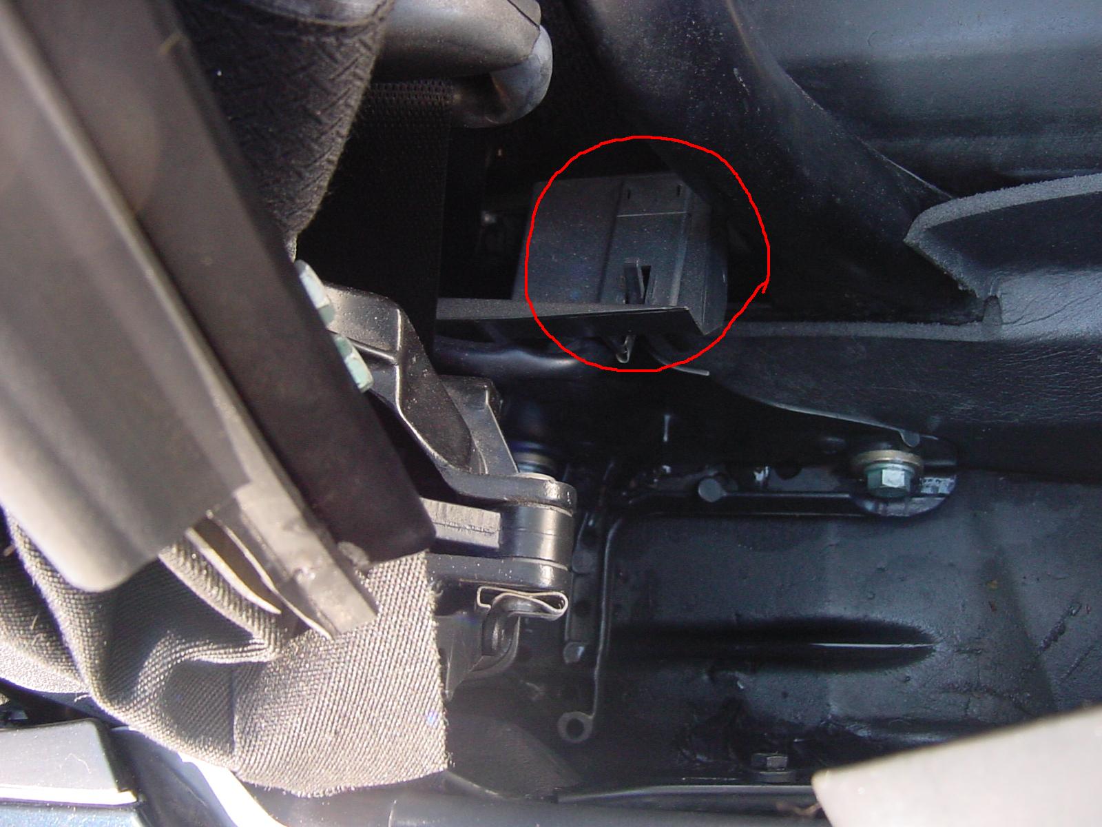

I was given a cable to plug in the rear defogger/defroster, but still can't find where to plug it into the harness. Any help here will me most helpful guys. Thanks!

Drew:
Here is where it plugs in (just pull up the little cover):

Thanks for the photo Maurice! :cheers:

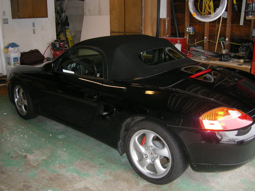

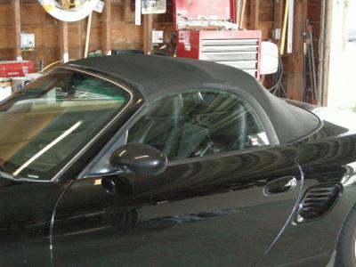

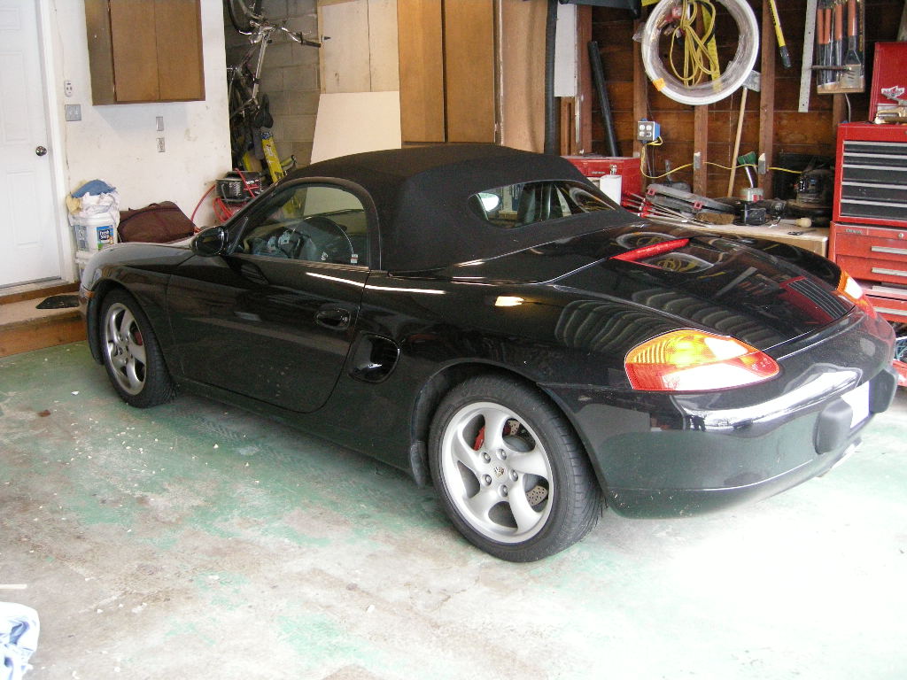

Heree you go. Sorry for the wait!
Nice Pics, Nice Top, Nice Boxster! :clapping:

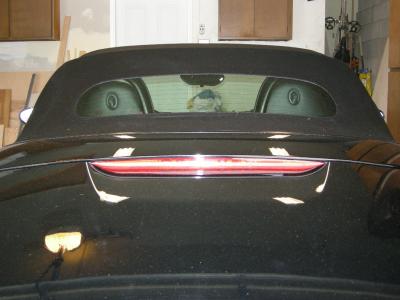

How's the visibility? Any issues with bigger blind spots?
Actually, I kind of like the smaller rear picture. It "fits" the rear view mirror better and I get MUCH LESS headlight glare at night from those following me. The car is darker in side all the time. With a black on black color combo, the car is dark inside anyway.
With two side mirrors and my experience riding motorcycles, I stay very aware of my side traffic, so blind spots really are not a problem.
The car looks like someone stuck a speedster top on it, which is cool with me. It is about two thirds the size of the original plastic OEM window. Which I say...good riddance!
