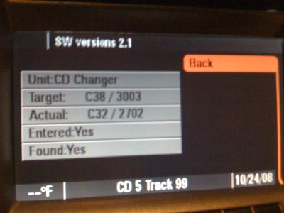

Here are my results from the MAIN and TRIP buttons...
It seems weird the target and actual are pointing to different places?

I have also installed Dension and aving similar question. Everything runs good no issues, but I have also noticed that when I press nav and trip, it shows me target as being 3003 while acutal being 2007.
any ideas??
I don't believe there is anything weird or wrong concerning the CD Changer PCM screen. Your PCM is expecting to see a 'Becker CD Changer' (ie. Target = C38/3003) and finds a Dension GW500 (Actual = C32/2702).
