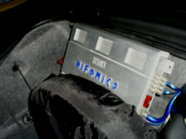

I'm personally planning to screw it on the lower left side when facing the spare tire. Is there any problem to use self tapping screws and screw the amplifier in the steel wall of the car? Do you have other options?
Thierry
I bolted the amplifier to a wooden board. I used rubber plugs to affix the board to existing holes in the car's sheet metal where the OEM amplifier bracket goes.
I "ditto" this... haven't done it yet, plan to do it this week. Installing 2 JL amps. I think the best method would be to construct a sheet of wood (like Oak Plywood) for the size of your amp(s), affix it using either rubber plugs as mentioned or with bolts screws to the OEM holes, and then mount your amp(s) to the board. The board can be placed behind the factory carpeting, or you can cover it yourself and affix it to the front of the carpeting.
Check the size / space you have available to the factory amp location first. You may have to attach to the side if the amp and board you are using are too big for the space behind the tire.
shouldn't be any problem,,,
something like this? or below the tire

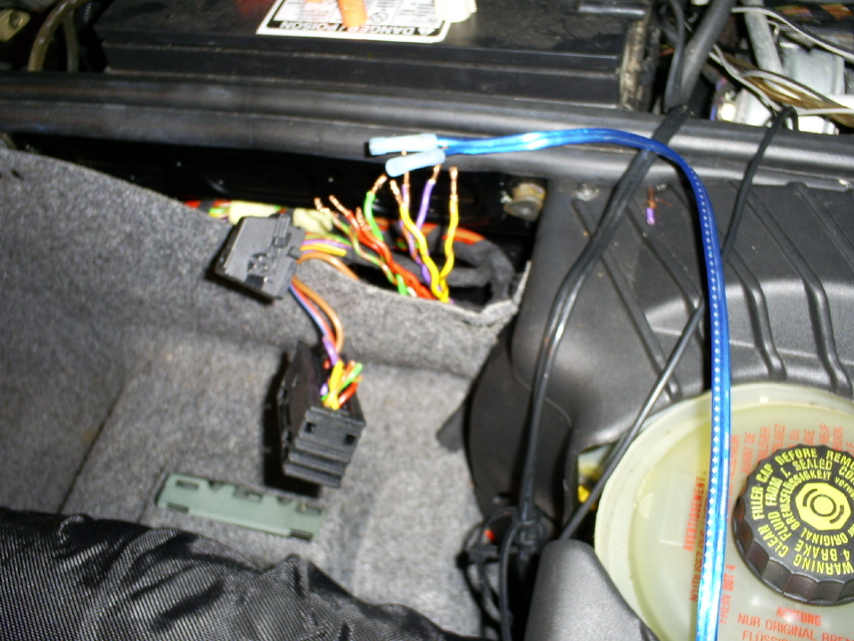

Just out of curiosity... what did you do for attaching your amp to the factory HAES amp connector? Did you end up chopping off the connector and splicing new speaker wires to it? Or were you able to make some kind of interface adapter to plug in to the factory plug? I'd prefer the later for my setup... but I haven't seen any posts on it yet. Just curious what others have done.
Finally decided to go by the front. Did built and rivet two steel brackets to offset the amplifier the same way the lock is. Looks nice, take not much space.

Right now, my thinking is as follows. I have a JL 300/4 Amp and a JL 300/2 amp that haven't been hooked up yet. Based on your response, it looks like I'll have to hardwire the plug as well. My thinking is to place the Front Dash speakers on 2 channels, and the rear deck speakers on the other 2 channels of the 300/4 amp. Thus in theory, the rears will have slightly less power going to each of the 4 speakers than the fronts, but that's ok seeing as they're really only staging speakers anyways. The 6.5" woofers in the doors will each be connected to the 300/2 amp giving them 150 watts each, which should be great considering the speakers are rated for 200 a piece.
