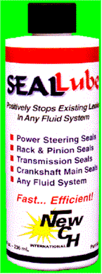

The power steering rack on my son's Grand Cherokee had a slight leak to it, as well. I bought a product called "Seal Lube", which a small amount is poured into the power steering fluid reserve. The product actually swells the rubber seals in the system and stops the leak. Oh yeah, it worked like a champ.
I found it on eBay, but you could probably buy it at almost any major auto parts store.
