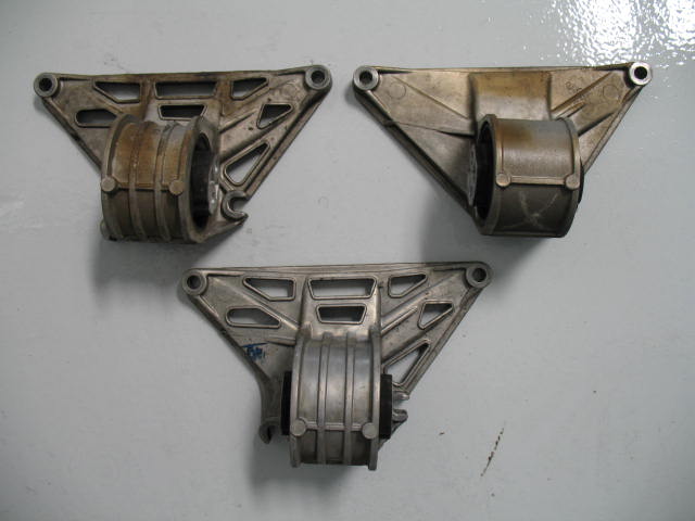

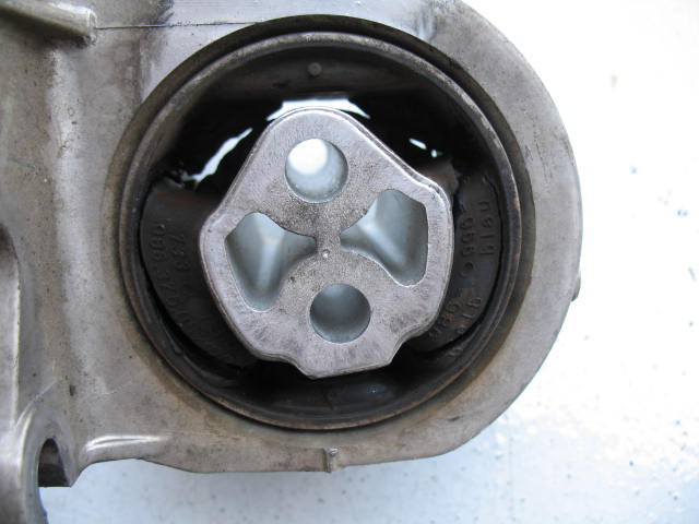

The noise can be from the motor mount. More so since it is a common problem and you have a lot of miles.
A local one man independent shop replaced 3 of them in a short period of time, to give you an idea of how common it is.

The mount in question is the main engine mount located in the centre of the vehicle near the serpentine belt, it's been updated to a 987 part number.

You can either replace the motor mount with an OEM part, repair it yourself with a kit made for that purpose, or buy a remanufactured mount.
Here's a link to a set of comprehensive DIY instructions with excellent photos for replacing a broken motor mount: http://www.pedrosgarage.com/Site%203/DIY%2...ne%20Mount.html
Good luck, and keep DIY'in.
