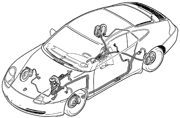

2. What order did you bleed in? For Carrera's it's: Right rear, Left rear, Right front, Left front. Isn't the TT the same?
Bleed order Rear right / rear left / front left / front right.
I never got any blue on the right rear, which i don't understand, there should have been some blue in the lines right?
Hmmm... very strange considering the right rear line is the longest line in the car. Any chance it was fluid from the previous bleed (before the super blue)? Also, you did open both bleed valves at each wheel (total of eight)?

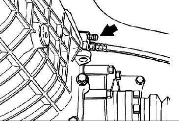

Remember that the reservoir holds fluid for the clutch and brakes. I wondered what would happen if the clutch line broke and you pumped all the fluid out of the reservoir - no brakes! I was told the reservoir has separate chambers for this reason. If you bled your clutch you would have been able to replace the fluid in that chamber. Jeff

I thought the clutch fluid was in the engine area.
