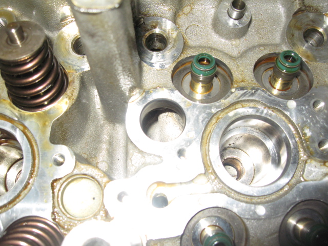

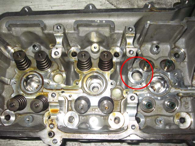

Has anyone had a freeze plug failure in a Boxster (or Boxster S) happen in the cylinder heads?
Our tear down of the failure of my newly acquired Boxster S is missing a plug.

This I believe is one and the same -- the plug I am referring to is in the cylinder head.
It caused coolant and oil mixture and **** the engine down.
It got mis-diagnossed as a cylinder liner crack --
I bought it site unseen planning on rebuilding via relining from LNEngineering -- but it looks like
although we ripped all apart -- we don't have to do that.
What I want to make sure is that if someone else had this problem -- what was the believed cause -- want to make
sure I am fixing the problem -- and not just addressing a symptom of something else.

yup that would be the seal plug,,,
cause is another defective internal part, old steel plug keeps failing,,,
But Porsche changed it in 98.
The plug must be replaced with a new plug made of aluminum !

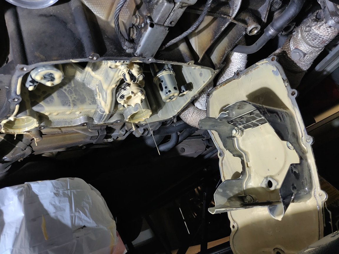

Old Post but want to add to the statistics of this problem.  My 1997 Boxster had a freeze plug let go.   Supposedly Porsche used Non-aluminum freeze plugs in the 1997 engine block where it can corrode and rust away.
I do auto cross so I run straight water.  Not knowing the freeze plug can corrode.  The plug corroded and I would lose coolant with no external leaks.  Only symptoms the loosing of coolant was very slow.   Occasionally start to get hot when sitting in traffic.

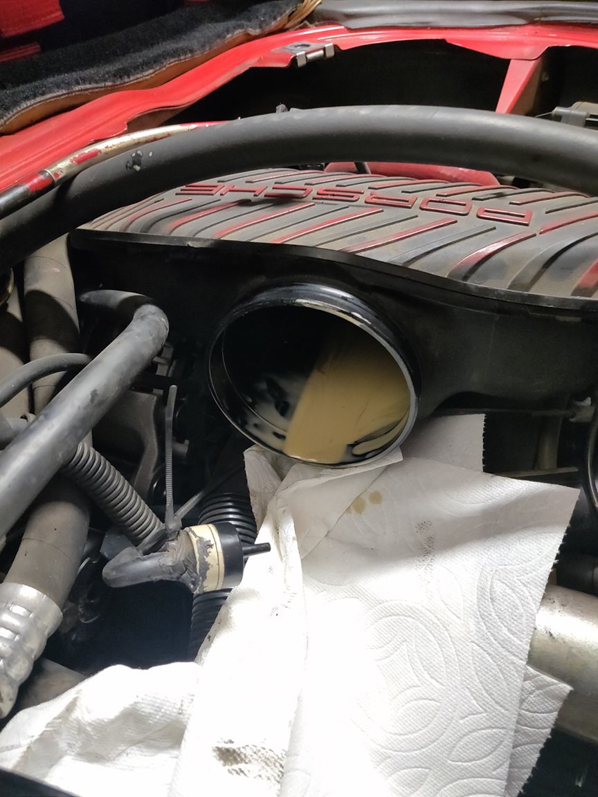

One day on the freeway the plug let go.  I get the coolant warning light.  Pulled over and noticed the entire coolant tank was emptied.  Thinking the expansion tank might have burped all the coolant out I added water to the tank, looked under the car for leaks, but there was none and I continue to drive.  In less than a minute the coolant light was on again.
I was completely puzzled, did the coolant tank burp all the coolant out again?  I added more water, but this time the water completely vanishes right away.   Pulled the dip stick and its milk shake.
Completely destroyed this engine thanks to internal freeze plug by the cam shaft that corroded away.
