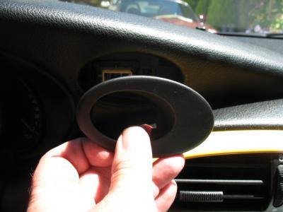

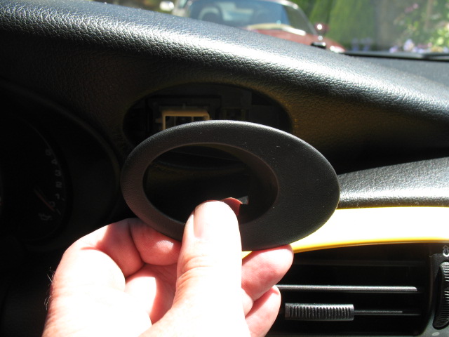

The oval trim just pulls out. If the cluster is covered with leather then you have to pull harder. A Boxster does not have this trim.
For the ground wire I use a ring terminal 1/4" size.
