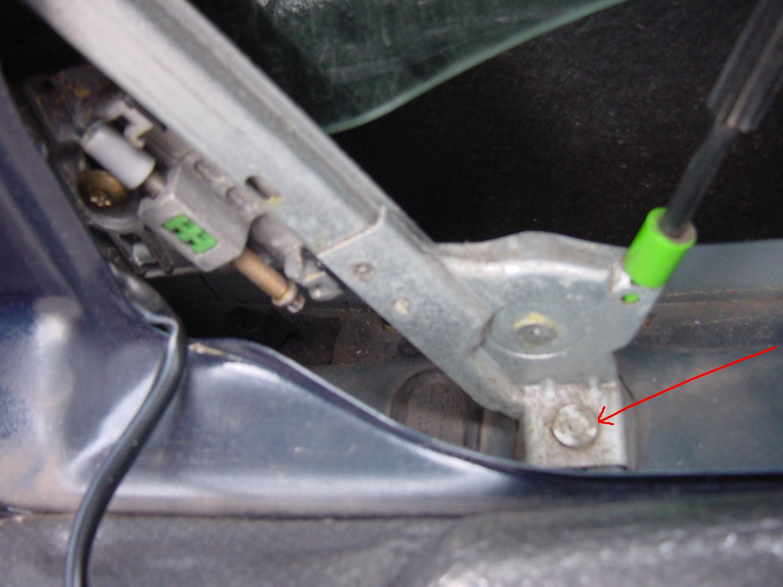

Here is a photo of one of the legs. This leg is on the driver's side door, towards the rear. The red arrow is pointing to the opposite side of the stud. The threaded part of the stud and the nut are on the underside.
You can also see the "other, outer" black plug just to the left of the base of the leg. You want the black plug that is directly under the stud, sealing the bottom of the door opening.
I hope I have remembered this correctly because I replaced the window regulator more than a year ago. I don't have my Boxster handy, but I'll check it out tomorrow and repost if necessary.
