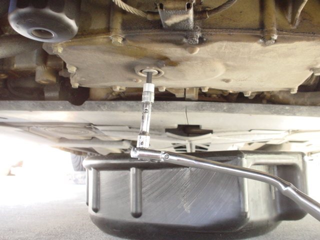

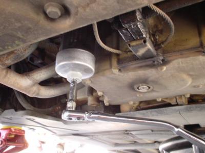

Tool Pants thanks for the pic. Is that your Boxster? or 996? I am going to have to double check to find the oil filter. I only took a quick glance the other day and I don't remember being able to see the filter like that. I do remember seeing the plug (drain).
It is a Boxster (see his reply above the picture). Also, that IS NOT the oil filter, rather it is the filter cover that you need to remove with the filter wrench remover. The actual filter is a cartridge that slides off/on underneath it.
The picture is a Boxster, as is this one. It is exactly the same set up on a 996 except the orientation of the engine is 180 degrees different. On a Boxster we jack up the left side. On a 996 you jack up the right side.
It is hard not to see the drain plug in the oil pan, and the black plastic filter cannister.
It is actually easier to change the oil on a 996 because the plug and filter are closer to the rear of the car. On a Boxster we have to slide under the car to get to it.
You will most likely need a tool to remove the filter cannister as they are usually on so tight.
