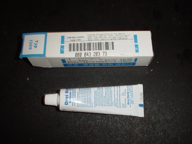

I used Loctite 574. Much better than any RTV silicone I ever used.
I watched a dealership mechanic replace one on a Boxster because the owner hit something and cracked the pan. Removed the bolts and pried it off. I think you know there is no gasket. He used a razor blade and cleaner to prep the surface.
He used whatever Porsche sells, which looked like a tube of silicon to me. He said they use to use the same stuff to seal windshield leaks.
