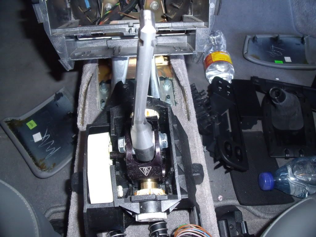

I purchased the white cable alignment tool to check my shifter cable alignment and obviously i don't have a stock shifter because the tool doesn't fit. Does anyone know what kind of this shifter this is and which tool i need (blue, green, etc..) to buy (and where to buy from?) to check my cable alignment? Thanks.
What is it doing that makes you think it is out of alignment?
Its a little tough shifting into first and second gear. Most of the time I have to do the neutral wiggle dance before getting it into gear. (My original post is at the very top). I was taking your advise (Loren) on checking the cable alignment. I have had the car for about 6 months - I wasn't aware I didn't have a stock shifter. When I had taken the center console out I did check to see if the cables were marked but they weren't. I thought I read elsewhere on the forum that a blue or green tool was available to check alignment on these shifters. Is this true and if so where can I get one? Thanks.
You can buy the short shifter aliment tool from any Porsche dealer for a few dollars. As I recall it is teal/green in color.
Just tell them it is for a Porsche Short Shifter.
I live in the middle of west Texas and there isn't any nearby Porache dealers. Does anyone know where I can buy one online? Been googling but can't find one...
Cal or email Sunset Imports (Porsche Parts at Dealer Cost) - I am sure they will have it for you - at a discount.
