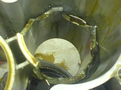

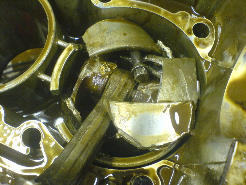

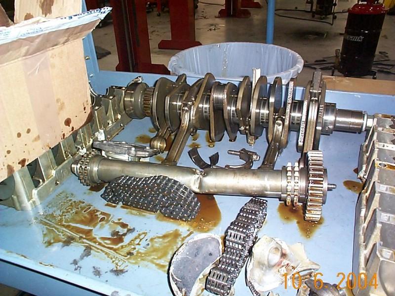

I forget where these pictures came from, but I think from Hartech on Piston Heads. It is a 996 3.6.
So, Jake, what do you think happened here?
Nope, I don't own the Castle, but when I visited and signed the guest book the lady at the desk looked at me really funny ;-)
I keep seeing the term "rebuild" with the engines and thats what most everyone is doing.. Few are actually addressing the root of the problem and upgrading the components and developing new, non Porsche parts to remedy the issues. The autofarm method is much better than factory, but its still not an ultimate method as part of the original cylinder is retained and another liner is installed. the LN emthod that we have helped develop replaces the entire cylinder and then Nikisil plating is used for a friction surface. This reduces temperatures as well as reducing the friction that typically causes the sleeves to dislodge. With this method employed the case has the same lifespan as an aircooled 911 cylinder, getting started at 200K miles.
The autofarm method still re-uses Pistons and even when the article was written a few years back the price for their upgrade was super expensive, something like 13,000 pounds for a stock engine!
The same goes with IMS and timing chain failures as well as oil pump issues as all of these things are either developed or we are developing them now...
It takes the same amount of labor to R&R the engine, tear it down and assemble it, so why not take the precautions to ensure future problems won't occur while you are at it??
I'd say that 3.6 saw some pretth bad detonation, maybe it was boosted without a CR reduction??? The pistons in these engines are VERY weak!!! A VW type 1 1600cc piston is the same size, but significantly stronger!
Lots of companies and independant repair shops have contacted us about our program already and thats what we want.. Our time is much better spent perfecting performance packages and designing components and procedures rather than assembling stock engines. We'd like to supply tools, parts and knowledge to assist the normal person with the 986 engine rebuild and upgrade..
Tool pants, are those your broken parts?? if so I'd certainly like to study them as part of our research as we are trying to create a data base of failures and components in hopes of establishing trends..
Edited by Jake Raby
Might be, since the rod bolts broke as wel as the beam too, but the crown of the piston looks baked, like it was well done under boost :-)
