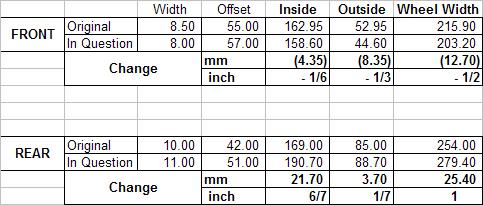

Hi Westcoaster,
I ran some numbers and it looks like the rear wheels will move slightly towards the suspension by 22 milimeters (2 centimeters), while the outside movement is almost negligible. Note that you could add some spacers to balance out the movement towards the inner side of the car. I don't think you would have a problem.
That being said, I would call a store that is used to Pcars and ask them just to make sure. Or hopefully someone with a 987 has done the same thing and will give their advice.
All the best,
Gus

Hi Gus, thanks for the chart, took me a few minuts but I see what you have done now.
I found that the front wheel of 8Jx19, RO 57 is a standard size for the Boxster Cayman, but as your chart shows the rear wheel is wider and has a different offset then that largest stock wheel: 10Jx19, RO42
So far no other 987 owners have chimed in, and since this set of tires/wheels are not local I can't try/fit before I buy...
