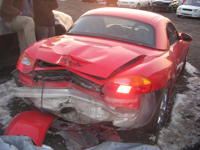

My Boxster had been in an accident when I bought it. Previous owner has spinned and crashed the car to a street lamp from behind. The exhaust and left rear axle carrier and shaft was trashed. I found that the impact had made one of the engine mounts break up. I was frustrated thinking I would come across worse internal engine and transmission problems in time. Anyway, I replaced the mechanical parts with good used ones. But the process took a little long, like 2 years :) since I wasn't able to find much time. So the car was sitting in the garage for 2 years, battery disconnected, never started it.

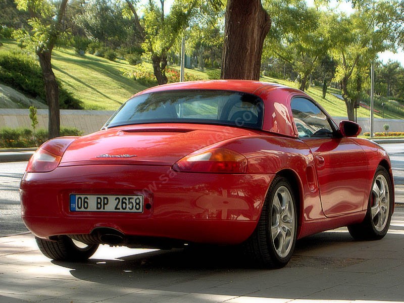

...I'm attaching some before and after photos, just for personal satisfaction :P
