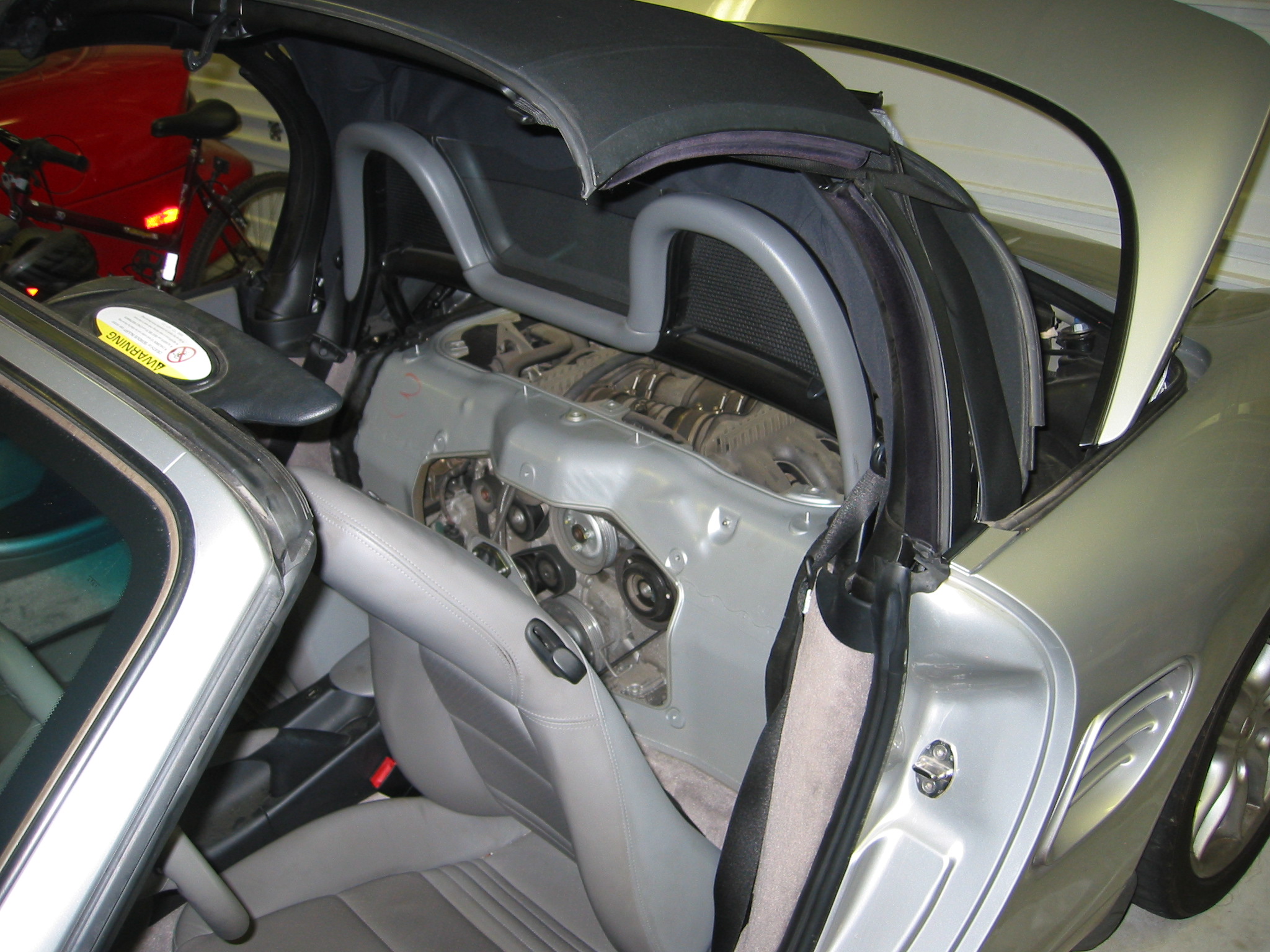

This link will tell you how to replace the actual belt. To get to the belt you have to remove the carpet behind the seats (remove 4 screws on top of the carpet), then remove the engine cover. Once you have it open, follow the instructions here:

Depending what options you have, you may have to prop up the top and take the subwoofer/tray and rear carpet out in order to be able to get the carpet behind the seats off. It's time consuming but fairly easy, though, and completely tooless- the instructions will be in your owner's manual. Once you get the carpet out of the way, it's obvious how to remove the cover plate. (Remember: german car, metric sockets!) Once you get it all off, it looks like this:
