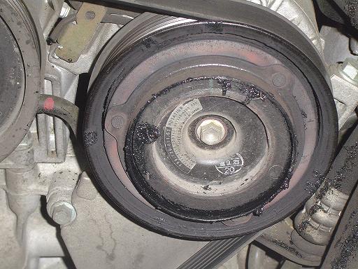

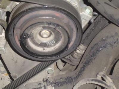

I was driving home and smelled burning electrical or rubber. I noticed my A/C became warm and inspected when I got home and look at compressor pulley area. What do you think it could be.
I will probably recharge, but which port is it left or lower right. A/C compressor still clicks on and air is still blowing but warm
Judging by the smell and the rubber dust all over the place, its safe to say your A/C compressor is seized. You'll need a new one and have to recharge the system.
With the firewall cover off, start the engine with the A/C off, then keep your eye on the compressor pulley and turn on the A/C, if the pulley on the compressor stops moving and the belt just slides on it, your compressor is junk.
thanks for the reply CJ...the belt and pulley move but the middle doesnt move with either the A/C on or off...do you think I can still drive the car without damaging anything else on the belt causing resistance if the pulley does seize?
thanks for reply..My car is at home and thinking of replacing clutch and found it at denso.com for $142.00 and if that doesnt work then I can buy the compressor w/out the clutch for $514.00...autozone had the compressor for $841.00 plus core for $65.00...
you need to replace both, the compressor and the clutch. The clutch has been damaged trying to turn a frozen compressor.

For some reason there seems to be a "spat" of electromagnetic clutch failures recently apparently due to the epoxy material surrounding the electric coil having not completely cured and then melting under use and engine compartment heat.
If you change the compressor, you should also change the dryer.
I believe you charge on the low pressure line, which is the smaller one, but you can't just put coolant in. You need to pull a deep vacuum on the system first.
Well I guess I will take my car to Mayos performance here in Hurst, Texas outside of Dallas for $1,600.00 smackaroos.....compressor, drier, flush, recharge etc...thanks to everyone that replied..
