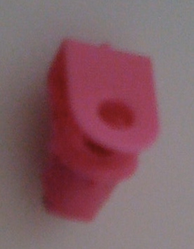

Turns out that one of the speaker screws is not sitting on the purple screw holding thing. I put some mounting tape in there and hope that's the cause of the rattle.
I realized that mounting tape was not the real part, so I went to the dealer and got the pink speaker screw receptacle for 72 cents. However, it seems that the pink screw receptacle is too large to fit into the screw mounting? I haven't been able to wedge it in there.
Any suggestions?
I have a 1999 996 C4, I was thinking maybe the parts changed from year to year and the dealer gave me a wrong part?
Is it part number 999.920.015.40 ? That's what my version of PET says it should be.
--Brian
Yup, sure is!
--Brian
Yup, sure is!
Finally got it. The pink spacer slides in from under the mount. It took a good 5 minutes of contorting my hand into very unnatural shapes and trying to not drop it into the dash.
